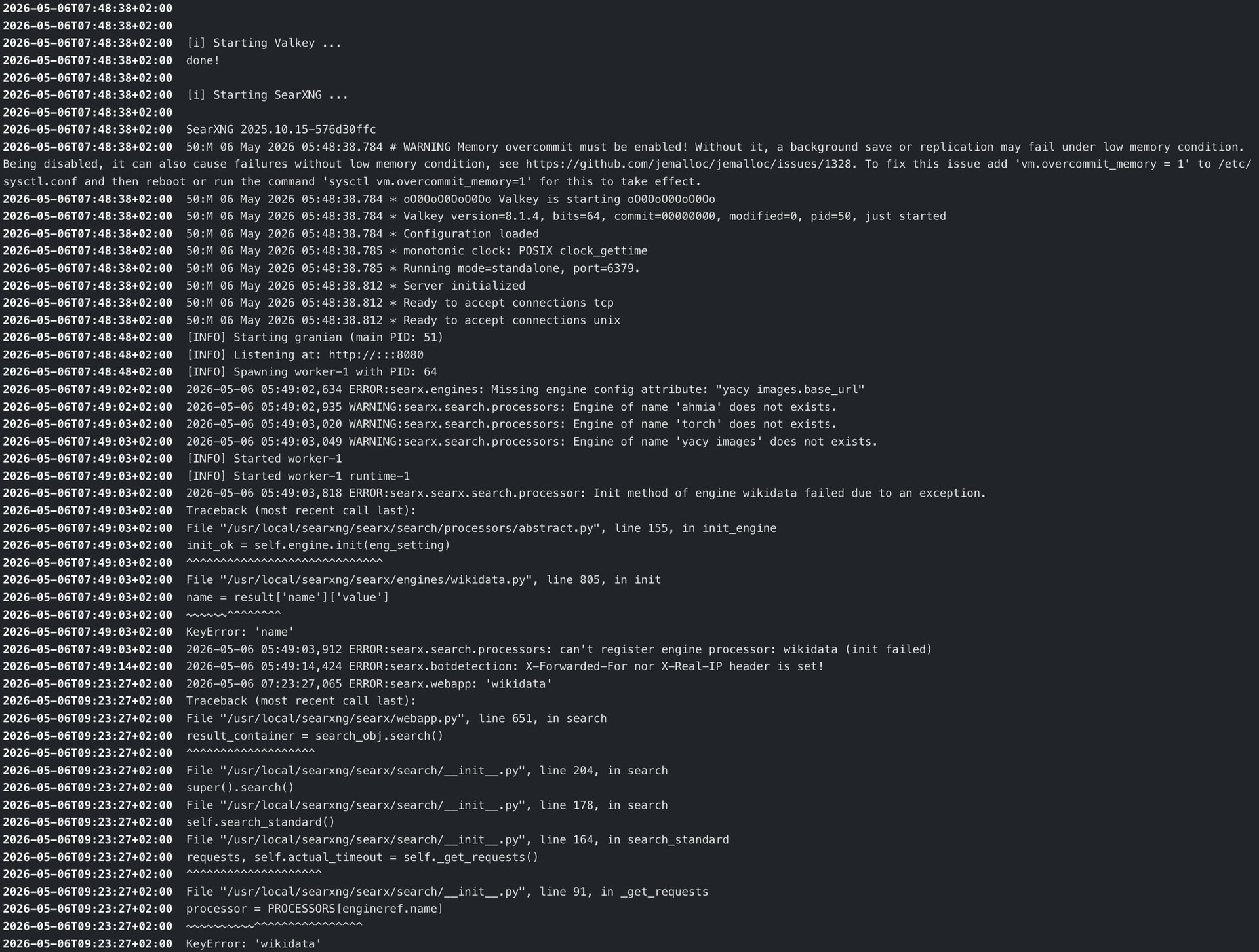

Powering the network devices off and on again didn’t help resolve the issue. I’ve taken a screenshot of the logs.

No one, much less Start9, has done anything to SearXNG to break it just for the fun of it. Wikidata has implemented a change in their systems to block SearXNG and stop it from accessing results, and has done so in such a way that it crashes SearXNG.
For their part SearXNG seems to have gotten around this change in later versions, since later versions of their software do work.

With SearXNG running, in the SearXNG UI, go to Peferences, then uncheck Wikidata, and then click save. SearXNG will continue to work until you’re able to move to StartOS v040.
Thank you so much for that tip! It really has sorted it out. :handshake:
