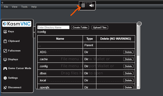

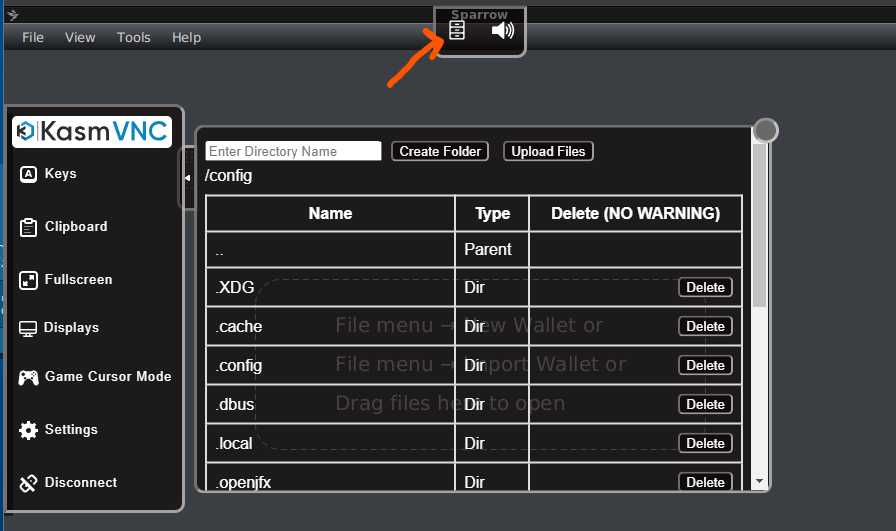

I have no personal experience with this, but I do believe there is a way to send a file to the webtop, in the interface.
