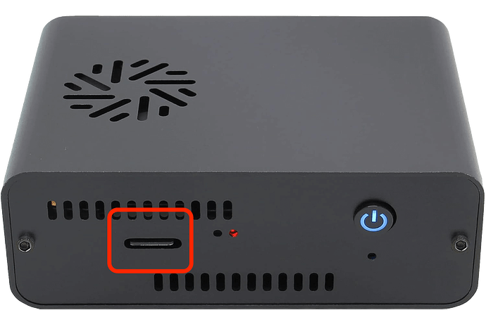

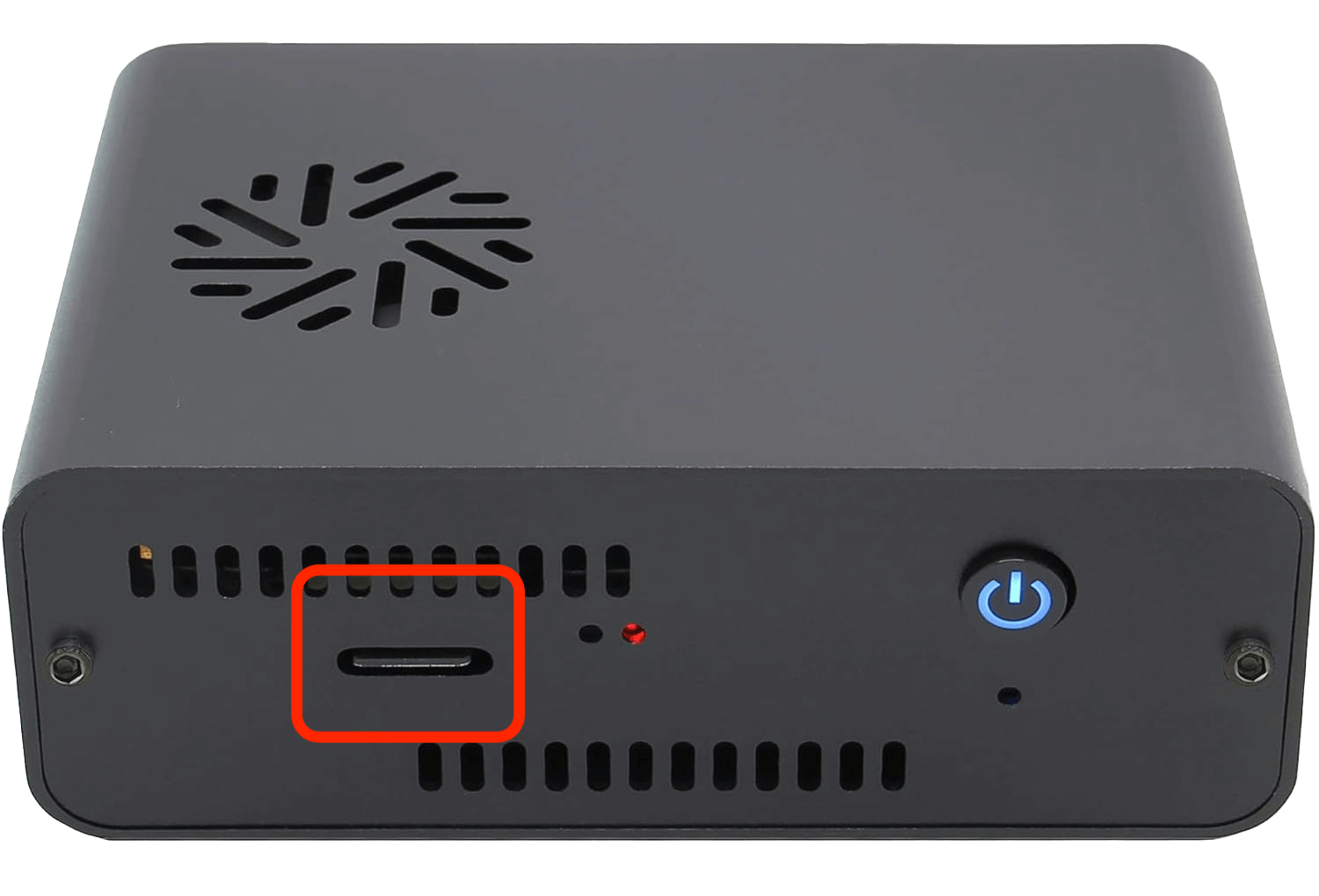

You are correct, I pulled the files with Windows, I can see the boot file and another on the os image sitting on the thumb drive after I etch it. But I cannot actually verify the files have the right bit size. I have started over from the beginning several times now. I am using an older server, it does not resemble the ones they sell on the website now.
I was wondering that myself! Looks like I need to pull the micro SD and load the raspberry pi file instead. The older servers must be more aligned with the server pure not the server one. I will try that tonight and update the thread, thank you!
Yep, your process is easier, and this explains why the USB didn’t boot! ![]()
Yep, just follow the RaspberryPi guide… different image file, same BalenaEtcher, etc you just need something to read an SD card on your computer.
Raspberry pi for the win! Appreciate all the help!!
