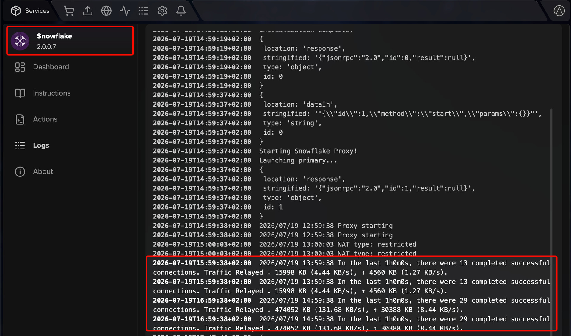

ill let it run as a test for now to see the difference in connections between NAT restricted and unrestricted…

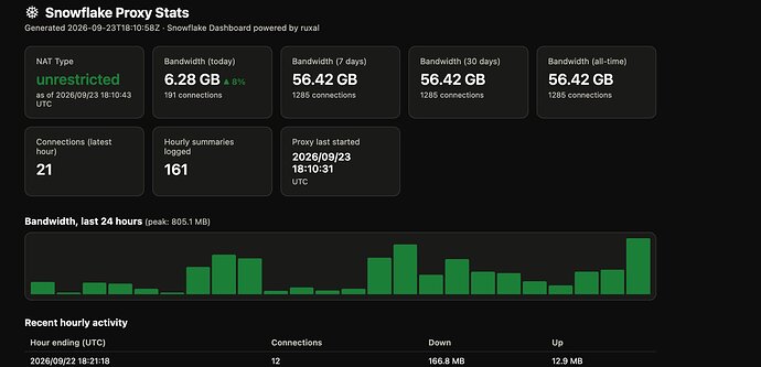

fair point let me see if i can update this and i hope its ok i forked yours :slight_smile: actually you can download it already from the beta community and see if there is something you recommend to adapt I added a new dashboard into the package nothing to fancy though.
I was very happy you forked it (which is why I put it there in the first place) and I saw the fancy dashboard :grin: . It seems its not only available in the beta community (I think). I couldn’t be more happy. A gap needed filling. I tried my best. Pros made improvements and it ended up in the community marketplace. Open source at its’ best :smiley:.

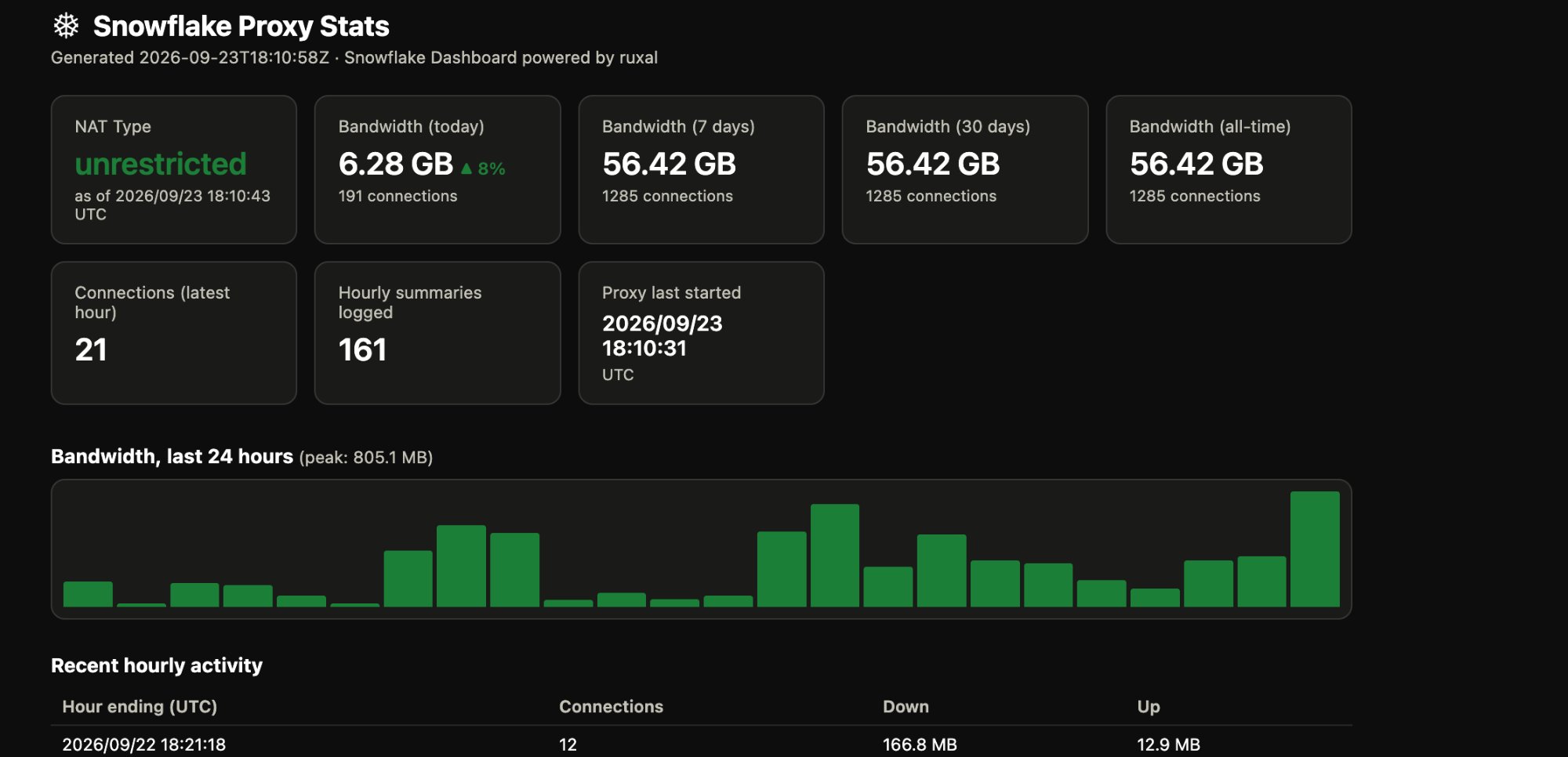

no worries thanks for letting me know… i have fiddled with the NAT around and i managed on Start9 to get it working towards unrestricted… yeah…
