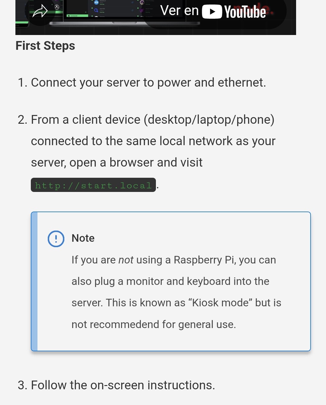

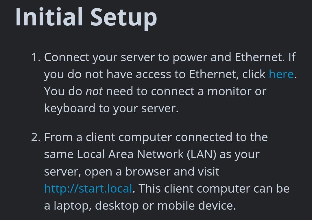

It does actually say this.
There’s no starting point where a monitor is connected. Everything begins with “on a client device” OR typing in start.local into a web browser (which you’d not be able to do if you’re on the server itself)
We could change the first part of every page of the guide to “on a client device” but it would be a little redundant as the guide starts off with you on a client device and none of the steps work on anything but a client device.
I have tweaked the language on the next version of the docs though. How’s this…
