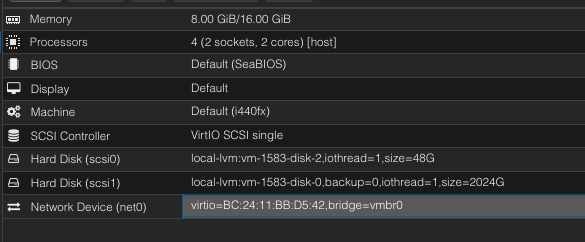

This is my HW config for StartOS on PM. I have two hard disks - one for the OS (scsci0) and one for the data (scsci1). The data is 2TB provisioned, but is on a remote NAS server - not local to the KVM. I could have used iSCSI for this, but I chose a NFS share on a NAS, so that the NAS can snapshot and backup the drive independent of PM. If the VM goes down, I can recover the OS drive from a backup quickly and it will reconnect. If the data drive goes down, I can revert to a previous snapshot or recover it on the nas from our backup server.
