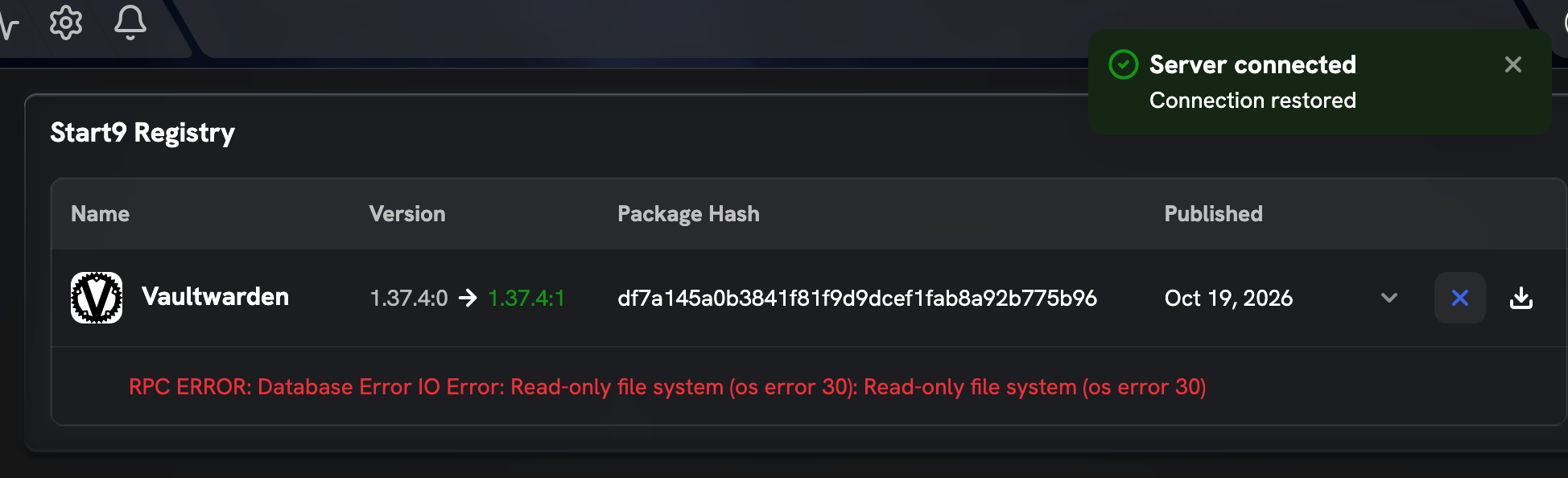

The most significant error is:
RPC ERROR: Database Error
IO Error: Read-only file system (os error 30)
This occurs when attempting to access notifications in the StartOS web interface.

Both the OS Logs and Kernel Logs viewers display:
Disconnected
Reconnecting
The notification interface produces the read-only filesystem/database error noted above.
