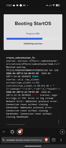

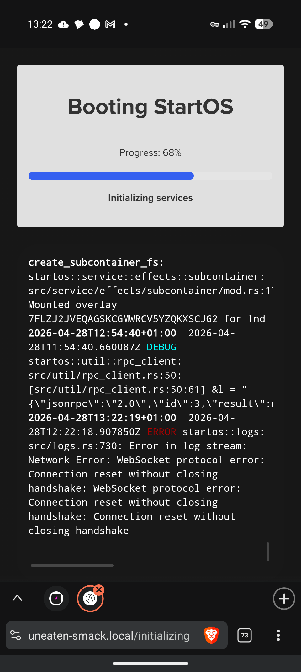

I upgraded to 0.4 beta 4 today and then upgraded in the web UI to beta 7. The server restarted but it’s not coming back online.
I’ve tried rebooting a couple of times and also starting in recovery mode but have not resvoled the issue.

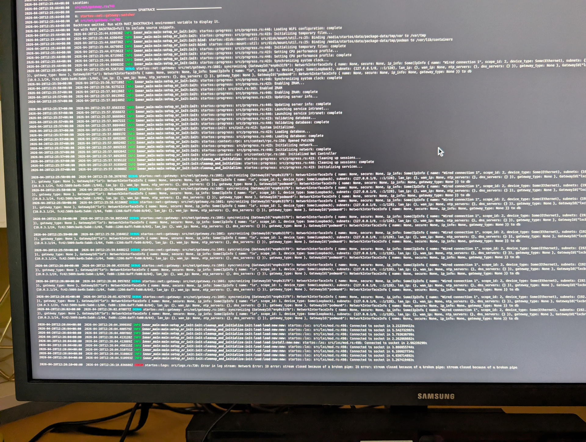

I’m seeing a network error as shown in the attached images. The devices has Ethernet network access which was working before reboot.
Relevant screens attached.
Update. I left the machine in this state for around an hour and it’s come online. Unsure what the issue was but hopefully it’s resolved. Will update if any further issues found.
Yes, patience is the way to go when updating from StartOS 0351 to StartOS 040.
Depending on how much data you have, it could take many hours to finish. Just let it do it´s thing and all will be fine.
