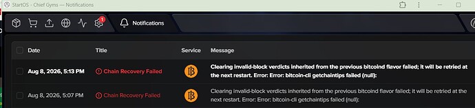

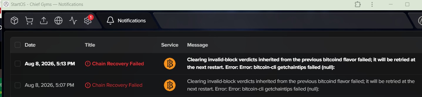

I tried to switch to Bitcoin Knots pre RDTS after the chain split but I’m getting the errors below. Does anybody know how to clear this error and reorg to the pre-RDTS chain? I thought switching and restarting would do it automatically but I’ve tried three restarts.
I checked my local mempool and it looks like the blocks are now updated and I’m back on the pre-RDTS chain. It just took some time and/or restarts.

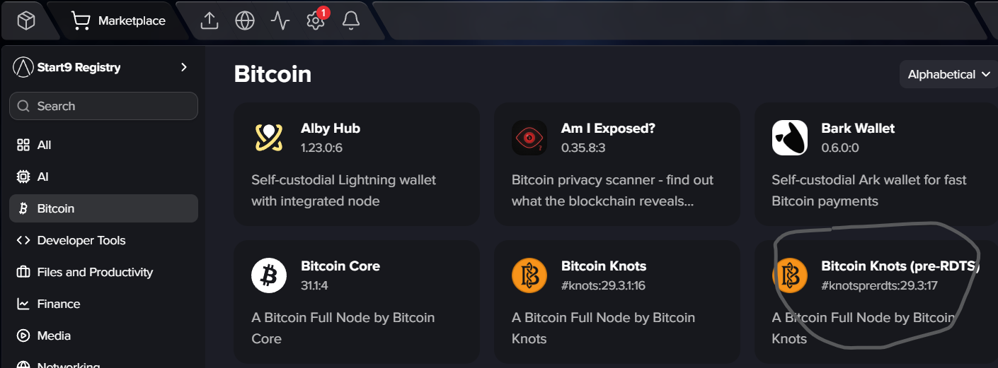

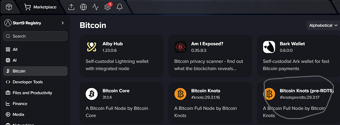

Got to the marketplace and look for Bitcoin Knots pre-RDTS. Click on it then select Switch.
That doesn’t look a thing like my marketplace. I think you’re on the new version of StartOS?

Yes I’m running the new StartOS. Regardless you should find Bitcoin Knots pre-RDTS in your marketplace. I think it’s re-indexing the entire blockchain so that might take a while. Maybe not like an IBD but it could still take some time.
