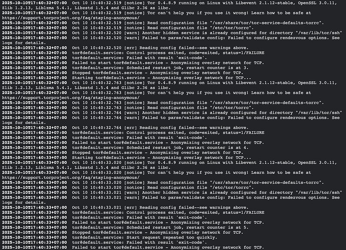

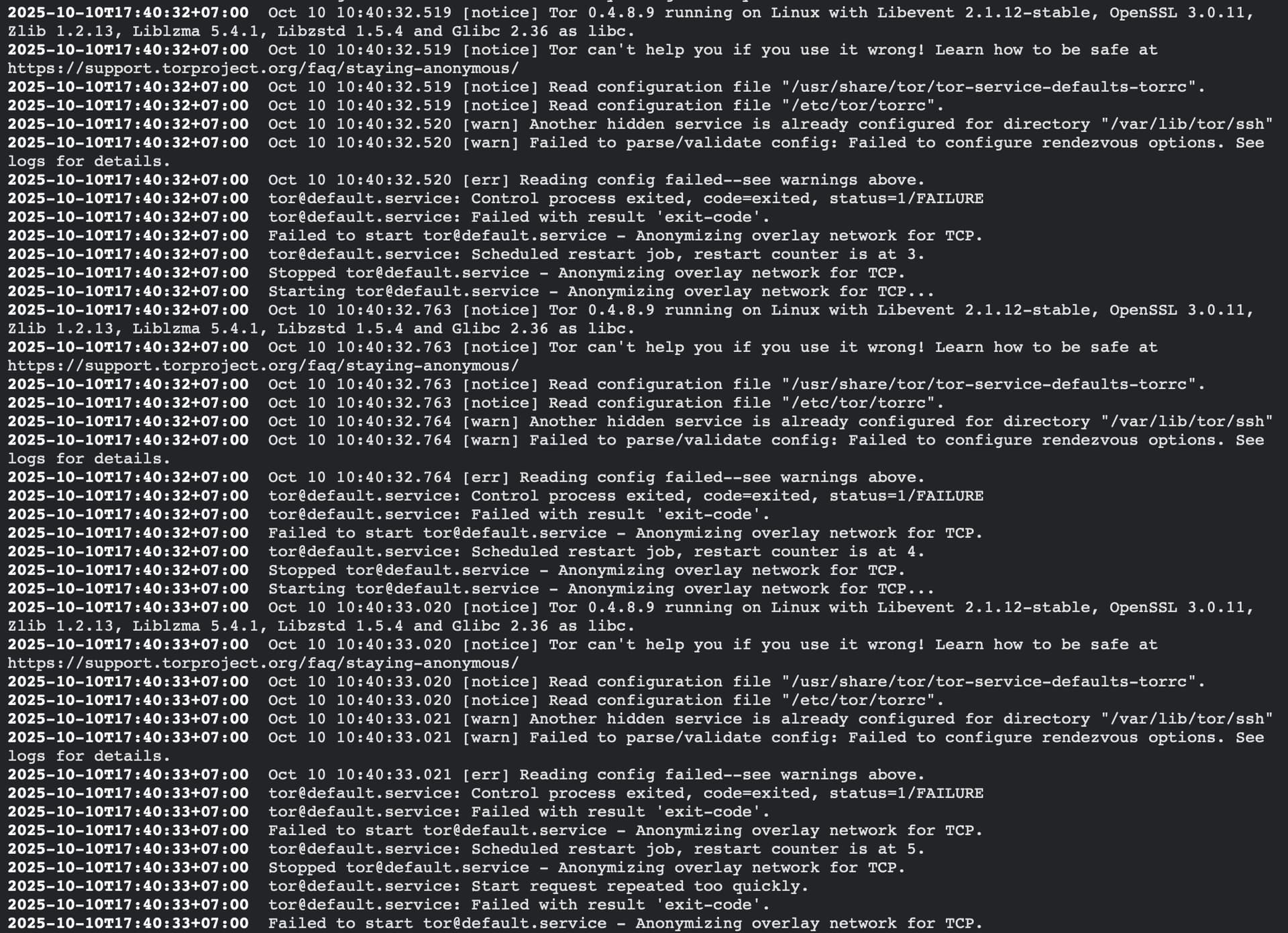

2025-10-10T21:02:15+07:00 tor@default.service: Scheduled restart job, restart counter is at 4.
2025-10-10T21:02:15+07:00 Stopped tor@default.service - Anonymizing overlay network for TCP.
2025-10-10T21:02:15+07:00 Starting tor@default.service - Anonymizing overlay network for TCPâŚ
2025-10-10T21:02:15+07:00 Oct 10 14:02:15.286 [notice] Tor 0.4.8.9 running on Linux with Libevent 2.1.12-stable, OpenSSL 3.0.11, Zlib 1.2.13, Liblzma 5.4.1, Libzstd 1.5.4 and Glibc 2.36 as libc.
2025-10-10T21:02:15+07:00 Oct 10 14:02:15.286 [notice] Tor canât help you if you use it wrong! Learn how to be safe at Am I totally anonymous if I use Tor? | Tor Project | Support
2025-10-10T21:02:15+07:00 Oct 10 14:02:15.286 [notice] Read configuration file â/usr/share/tor/tor-service-defaults-torrcâ.
2025-10-10T21:02:15+07:00 Oct 10 14:02:15.286 [notice] Read configuration file â/etc/tor/torrcâ.
2025-10-10T21:02:15+07:00 Oct 10 14:02:15.287 [warn] Another hidden service is already configured for directory â/var/lib/tor/sshâ
2025-10-10T21:02:15+07:00 Oct 10 14:02:15.287 [warn] Failed to parse/validate config: Failed to configure rendezvous options. See logs for details.
2025-10-10T21:02:15+07:00 Oct 10 14:02:15.287 [err] Reading config failedâsee warnings above.
2025-10-10T21:02:15+07:00 tor@default.service: Control process exited, code=exited, status=1/FAILURE
2025-10-10T21:02:15+07:00 tor@default.service: Failed with result âexit-codeâ.
2025-10-10T21:02:15+07:00 Failed to start tor@default.service - Anonymizing overlay network for TCP.
2025-10-10T21:02:15+07:00 tor@default.service: Scheduled restart job, restart counter is at 5.
2025-10-10T21:02:15+07:00 tor@default.service: Start request repeated too quickly.

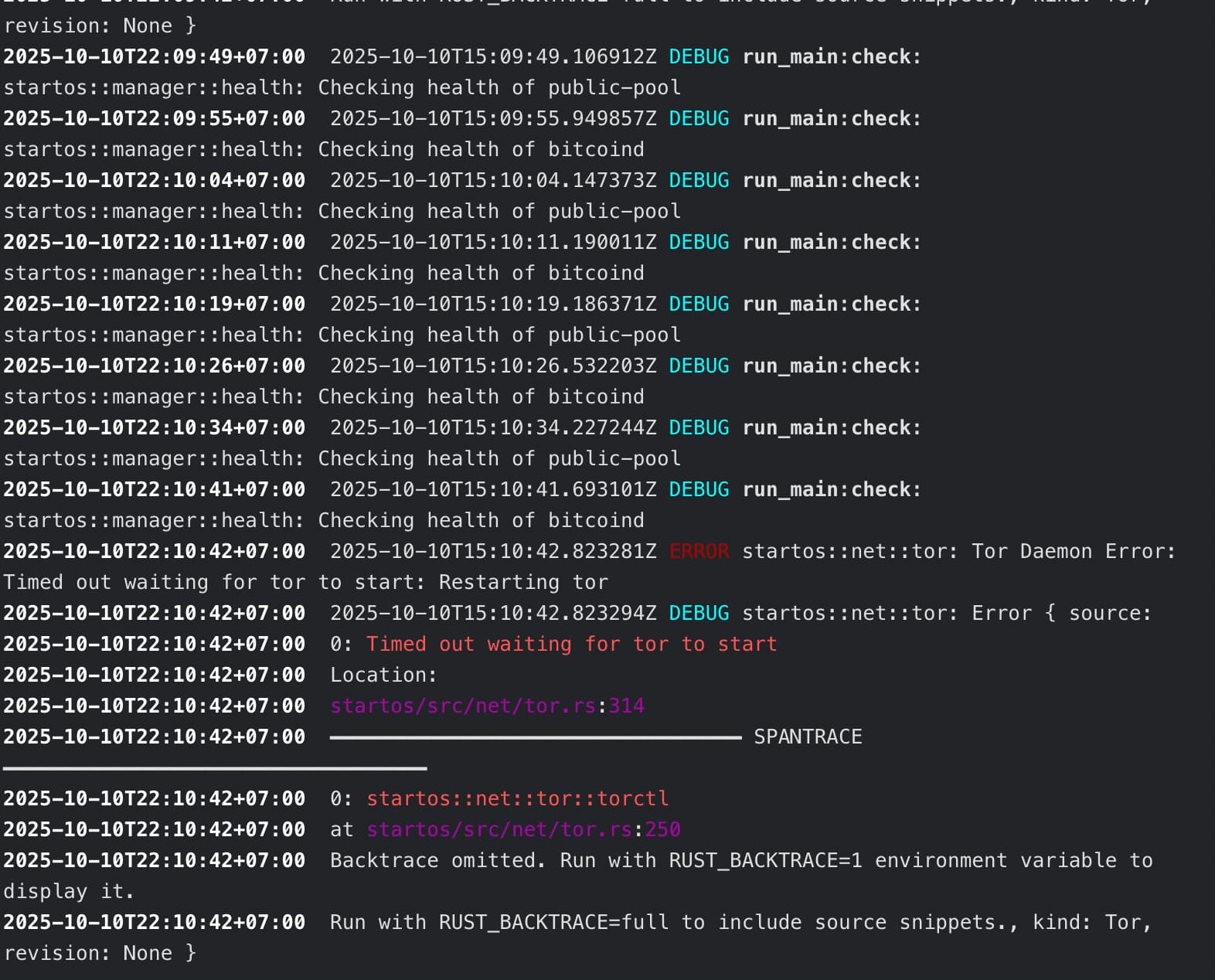

reset tor wipe alot of time still getting the same results
2025-10-10T21:21:10+07:00 Oct 10 14:21:10.281 [notice] Read configuration file â/etc/tor/torrcâ.
2025-10-10T21:21:10+07:00 Oct 10 14:21:10.282 [warn] Another hidden service is already configured for directory â/var/lib/tor/sshâ
2025-10-10T21:21:10+07:00 Oct 10 14:21:10.282 [warn] Failed to parse/validate config: Failed to configure rendezvous options. See logs for details.
2025-10-10T21:21:10+07:00 Oct 10 14:21:10.282 [err] Reading config failedâsee warnings above.
2025-10-10T21:21:10+07:00 tor@default.service: Control process exited, code=exited, status=1/FAILURE
2025-10-10T21:21:10+07:00 tor@default.service: Failed with result âexit-codeâ.
2025-10-10T21:21:10+07:00 Failed to start tor@default.service - Anonymizing overlay network for TCP.
2025-10-10T21:21:10+07:00 tor@default.service: Scheduled restart job, restart counter is at 5.
2025-10-10T21:21:10+07:00 Stopped tor@default.service - Anonymizing overlay network for TCP.
2025-10-10T21:21:10+07:00 tor@default.service: Start request repeated too quickly.
