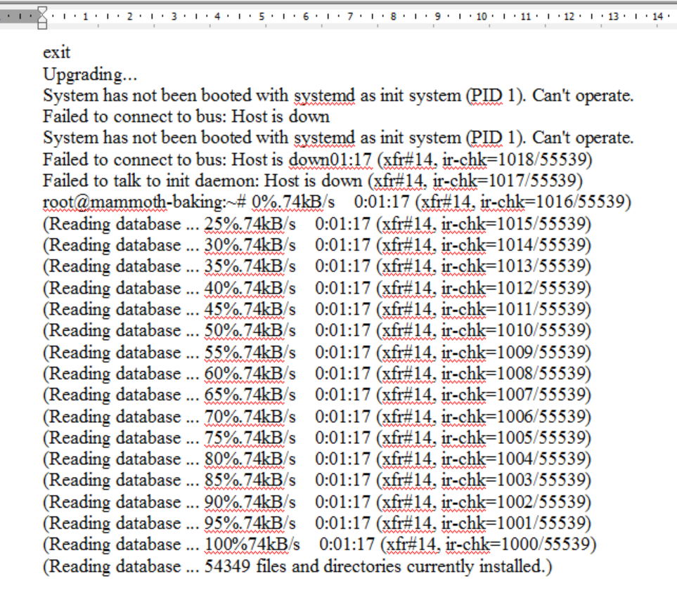

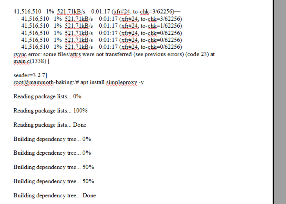

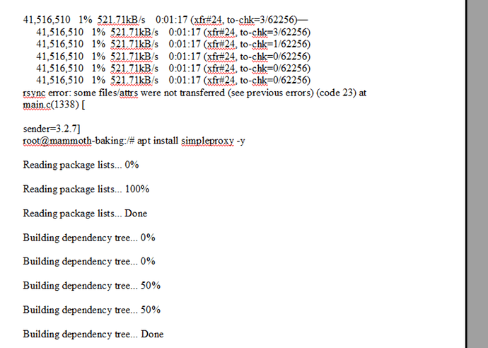

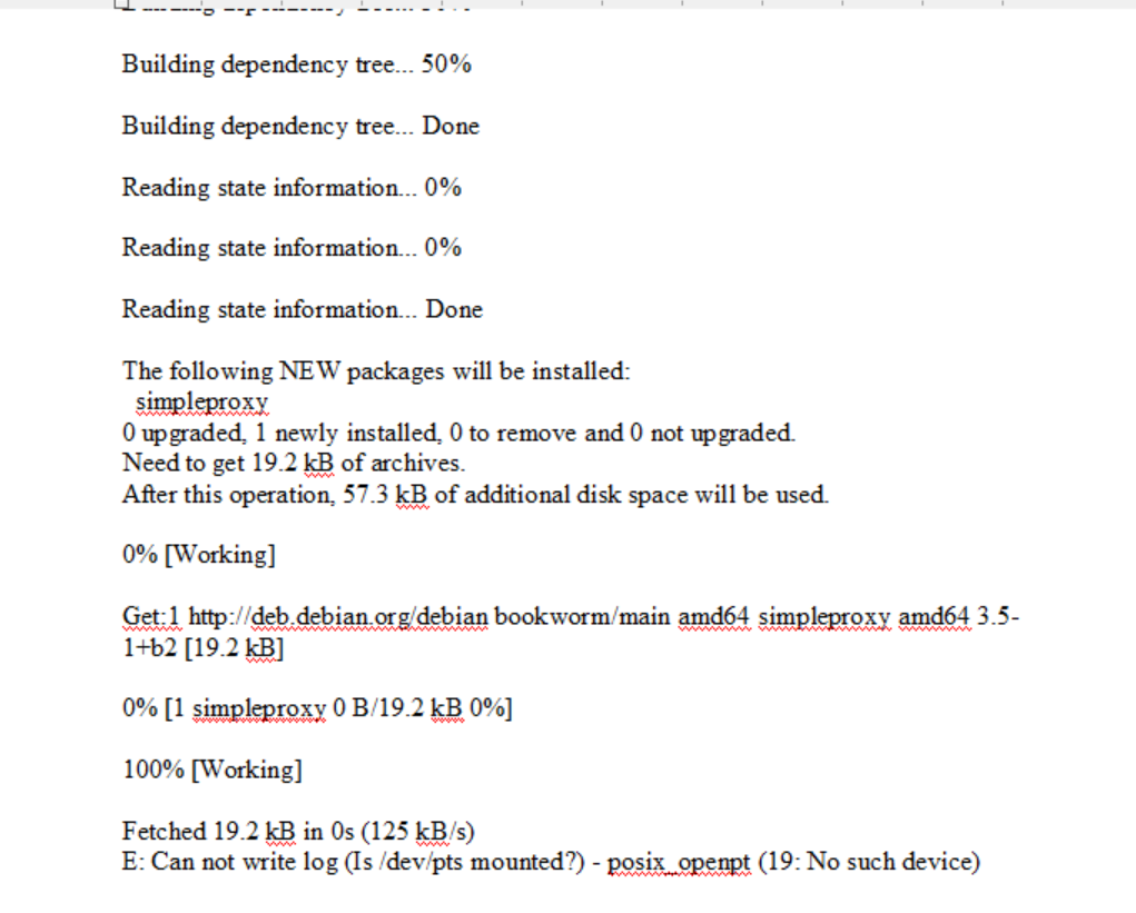

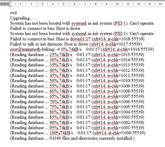

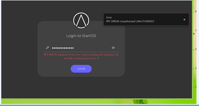

Proud New Server about a week ago & so far only installed Knots/110, Electrum & Datum Gateway. Just finished inputting all the SSh command line inputs necessary for Datum to install and run the Simple Proxy, but after the inputs were completed the terminal was giving some error messages (I have screenshots) and the server didn’t restart afterwards as I thought it should. I then checked the Datum gateway service within start9 and it was showing that it wasn’t running properly (I 'd been still logged into my server all the time), but after I clicked on the Datum Gateway GUI tab to see what was happening there it opened up in another page and since then I haven’t been able to log back into my start9.
I’d try just switching it off and back on again to see if that sorted it but maybe thought it best to try check here first if anyone’s any advice. Included an attachment of failed login attempt, and also some of the error messages after trying the Simple Proxy install (if they’ll upload for me)…any help most welcome :slight_smile:
I’d definitely try restarting the server first and seeing if that clears anything up. What type of Start9 server do you have?
Hey, thanks for reply and I’ve tried that in the meantime but no change, also can’t access it by IP address and my modem now doesn’t see it anymore anyway. I also tried to SSH into the server again but it just tells me that the connection has been reset for that IP address. I’ve just gotten a first response back from Start9 and it looks like it might entail flashing the OS from new but I’ll check in with them again before I try that as if at all possible I’d like to avoid all that hassle :slight_smile:

Problem Finally Sorted. Followed Instructions from Server Support to download & flash Start9 OS and am back in again with zero data loss …Success! As a Tip for those using older Windows OS versions…to execute the Flash I needed to first search for an older compatible version of the recommended “BalenaEtcher” s/w before I could install it …and same with “Element” which was needed to access the Private Support Server.
