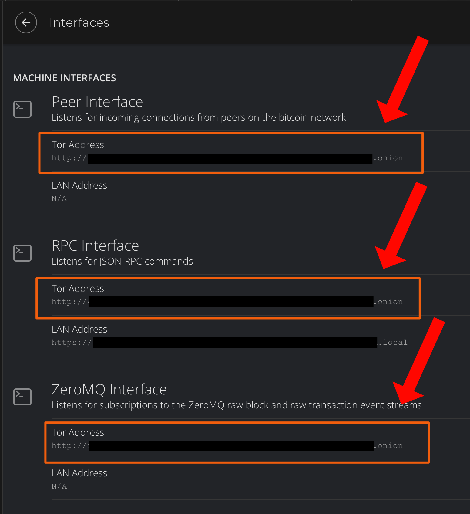

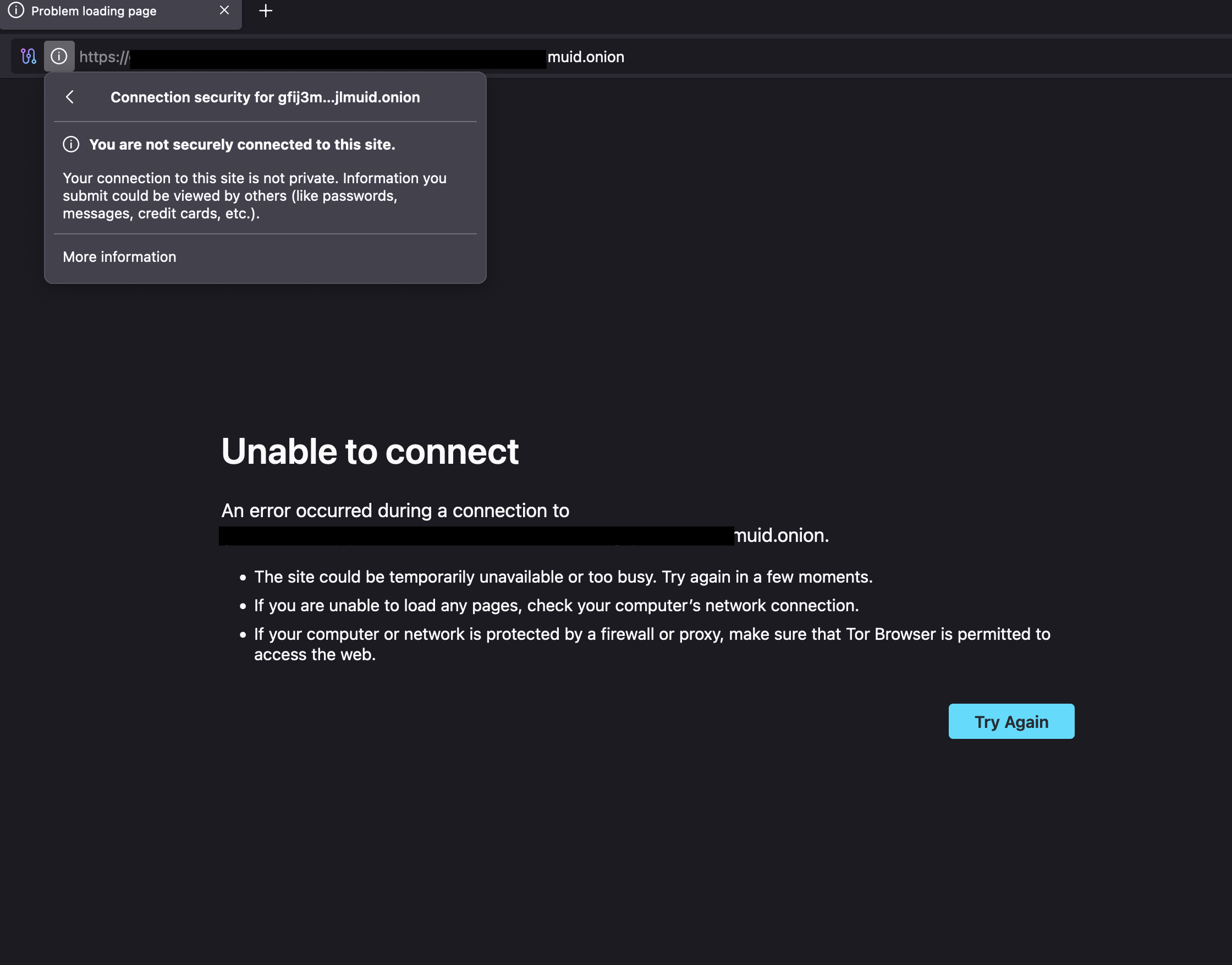

I have been trying to open my Knots Peer interface but it has been imposible. From StartOS browser and Tor browser (from two different devices) Funny thing is that I can reach any other .onion URL such as Start9 site but no the interfaces of my node.
- LAN interfaces work fine (it is a same there is no LAN interface for Peers)
- Firefox config is fine on my Start9 server
- On my other devices, Tor browser is connected and I can reach any other .onion URL
I reseted Tor under “Experimental features” both with and without wipe state
Reading Tor logs I noticed this:
Guard raylund ($2C164169C508C104985551D19D6F76652DC184A6) is failing a very large amount of circuits. Most likely this means the Tor network is overloaded, but it could also mean an attack against you or potentially the guard itself. Success counts are 65/151. Use counts are 36/36. 65 circuits completed, 0 were unusable, 0 collapsed, and 0 timed out. For reference, your timeout cutoff is 60 seconds.
And this:
Guard BrightWowRelay ($DFD6E9BF7F2194C13F95D07EE9CCFAB099372969) is failing a very large amount of circuits. Most likely this means the Tor network is overloaded, but it could also mean an attack against you or potentially the guard itself.
Any ideas?
