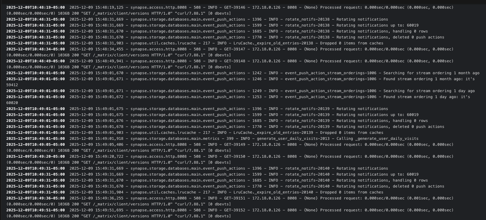

I’ve attached the Matrix Synapse logs:

The Synapse logs show no errors—all operations (health checks, notification rotation, cache maintenance) complete normally.

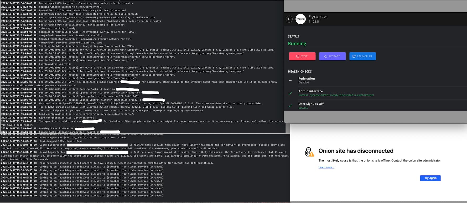

Thanks for the help. The health checks appear good on the synapse service page. When I try the .onion address, it does not work and it says Onion site has disconnected (The most likely cause is that the onion site is offline. Contact the onion site administrator.)
I reset tor connections and did a fully embassy reboot. Unfortunately it seems like the whole embassy is unreachable by tor currently, even though the other services were working fine in the last few days. Here is a screenshot of the tor logs.

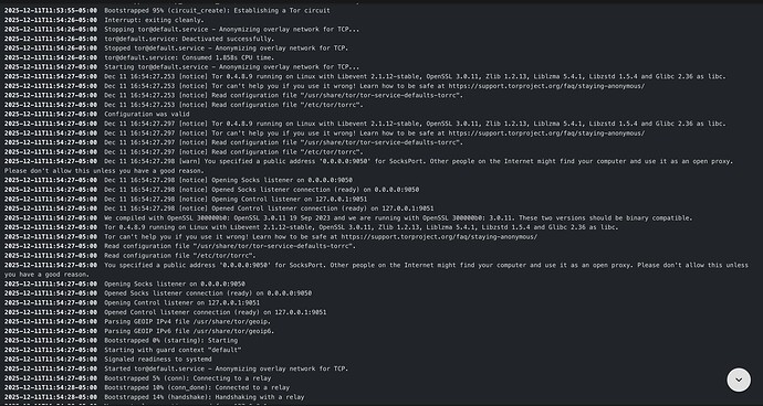

Still able to connect through LAN, cannot connect through Tor though. Here are the tor logs:
Basically it keeps getting to 95% and then interrupting. Not really sure how to fix the tor connectivity issues here.
