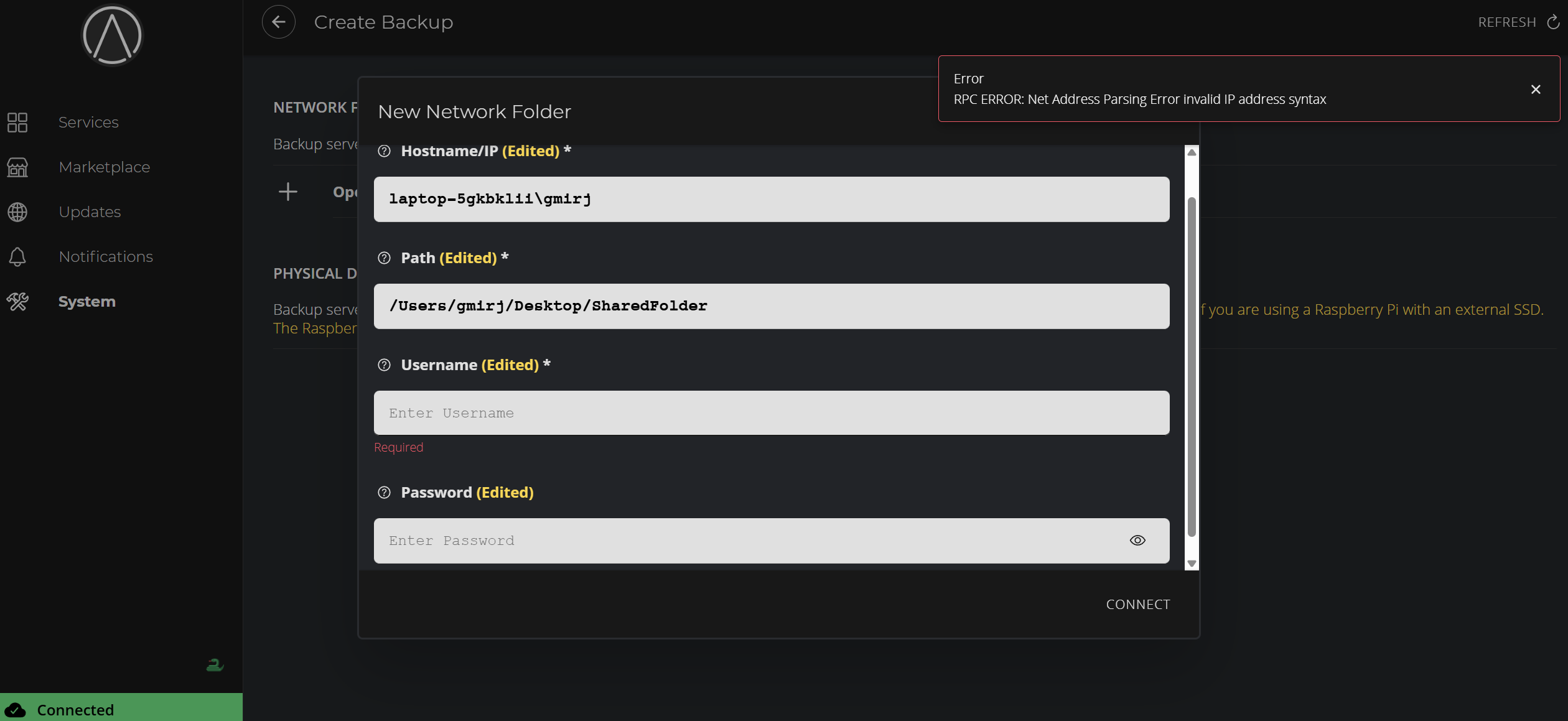

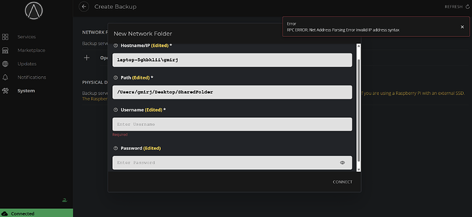

I read that it a USB might be easily corruptible, but the reason I was going that route is because I’m having problem backing up to a network folder since the system can’t recognize my Hostname/IP.
I went into the command prompt and typed whoami to get my windows user name. But when I use this user name, I get an error “RPC ERROR: Net Address Parsing Error invalid IP address Syntax”
If i type my Ip address, it gives me an even longer Error Message.

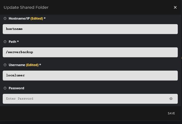

Can you share a screenshot with your network folder configuration? Sounds like you type something wrong when creating network backup.
That most likely is the case.
Is this the screenshot you are asking about?

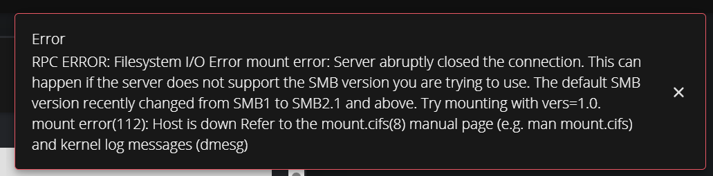

The second picture is of the Error I get if I input my IP address:
Hostname should not include the username
Path, is the network path to the shared folder. Not the full path on the host machine
The user needs to be a local only user. Not a user connected to a Microsoft account. I recommend creating a backup user, that’s used solely for this purpose.
