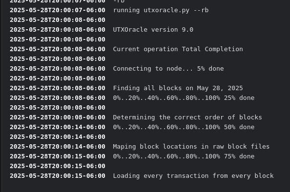

I decided running the script with ssh is a bit silly and almost done with the proper .s9pk package.
It’s working. For now you can experiment via Sideloading utxoracle-startos
Alpha release https://github.com/citizenanalog/utxoracle-startos/releases/tag/alpha
Anyone give it a shot yet? 0.9.4 is pretty polished. Waiting to hear back on the registry submission.
It runs pretty quick on my intel i5 (~20 sec) and a bit slower on an 8GB CM4 Pi (~1:30).
Latest release. https://github.com/citizenanalog/utxoracle-startos/releases
Works on both core and knots, if anyone is interested.
