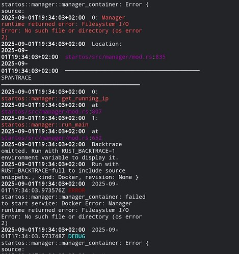

Checking the system logs in this situation was indeed a good idea: nothing appears in the Kernel logs or in TOR logs, but OS logs are showing some messages and warnings in a loop, until i stop the service. Attaching screenshot.

Not sure why it’s giving the “no such file or directory” error, and what it’s trying to access… can you paste those logs as text? Some of it is cut off in the image.
2025-09-02T00:00:20+02:00 0: startos::manager::get_running_ip
2025-09-02T00:00:20+02:00 at startos/src/manager/mod.rs:807
2025-09-02T00:00:20+02:00 1: startos::manager::run_main
2025-09-02T00:00:20+02:00 at startos/src/manager/mod.rs:652
2025-09-02T00:00:20+02:00 Backtrace omitted. Run with RUST_BACKTRACE=1 environment variable to display it.
2025-09-02T00:00:20+02:00 Run with RUST_BACKTRACE=full to include source snippets., kind: Docker, revision: None }
2025-09-02T00:00:20+02:00 2025-09-01T22:00:20.647239Z ERROR startos::manager::manager_container: failed to start service: Docker Error: Manager runtime returned error: Filesystem I/O Error: No such file or directory (os error 2)
2025-09-02T00:00:20+02:00 2025-09-01T22:00:20.647425Z DEBUG startos::manager::manager_container: Error { source:
2025-09-02T00:00:20+02:00 0: Manager runtime returned error: Filesystem I/O Error: No such file or directory (os error 2)
2025-09-02T00:00:20+02:00 Location:
2025-09-02T00:00:20+02:00 startos/src/manager/mod.rs:835
2025-09-02T00:00:20+02:00 ━━━━━━━━━━━━━━━━━━━━━━━━━━━━━━━━━━ SPANTRACE ━━━━━━━━━━━━━━━━━━━━━━━━━━━━━━━━━━━
I could not check more logs after last post, because when i try to run the service (Wasabi), the OS logs gets clogged with the error loop commented before, as it is repeted like 2 or more times per second.
