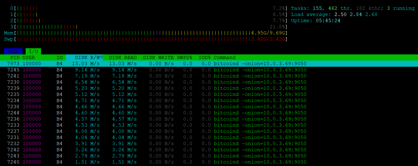

Why is bitcoind thrashing my hard drive?
I don’t understand why there needs to be 15 bitcoind threads all reading multiple megabytes/sec from the drive, all the time. Is there some way to curb this? I am running electrs and mempool, but I don’t think it used to be this way before I upgraded to start9 4.0 (currently running beta8, but betas 5-7 showed the same behavior).

Killing electrs and mempool stops this behavior. I am going to switch to fulcrum for mempool indexer, supposedly that should help quite a lot. Will report when switched over.
Alright, so electrs wasn’t actually the issue. Or if it was, fulcrum completely solved that part. The actual issue is that mempool keeps querying bitcoind for transaction data instead of just using fulcrum, and forces it to read old blocks from the disk. I think I’m just going to stop running mempool since it’s retarded. I still think it didn’t use to do this before. I might try uninstalling and installing an old version of mempool.
