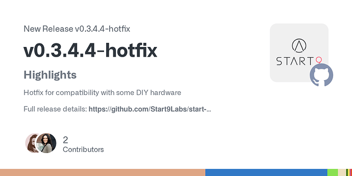

The “cannot downgrade” is a bad error message, unfortunately. It just means you are coming from an older version. StartOS had a cliff version at 0.3.4 so we deleted the 0.3.3 migrations from the code. You are likely coming from 0.3.3.1 or earlier, which means you will need to reflash 0.3.4.4 before going on to 0.3.5.1

When you say “you will need to reflash 0.3.4.4 before going on to 0.3.5.1”, do you mean I need to do a clean install or does reinstalling option (keeping data) works also? Thanks
Do a re-install, keeping data, as opposed to factory reset, which would wipe data.
It worked :tada: I’ve got the system back.

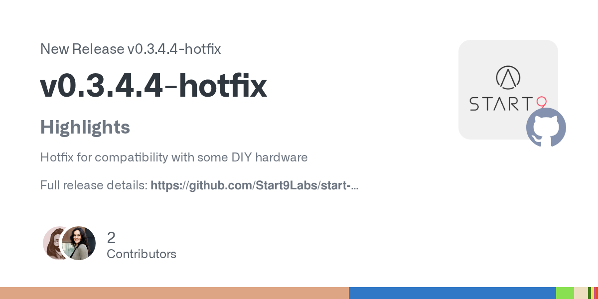

Originally, I did have the same symptoms as Nunosav, but not the same message. I wasn’t able to grab a screenshot of that, but I have since tried to re-install from USB flashdrive and I am getting these errors messages on command line. Tried flashing both 0.3.5.1 and 0.3.4.4 (hotfix).
Are these just messages in your log, or do you have other issues stemming from this? It looks like you may have some peripheral devices attached that are not needed. Either way, this probably warrants a new topic with the context and details, please.
