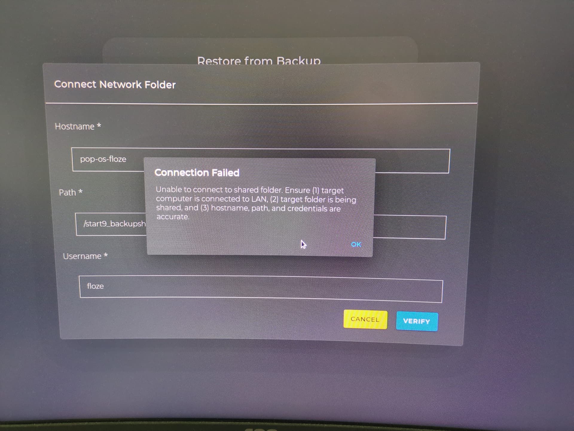

when i restarted my Start9 server I had an issue as described here:
I got some assistance to solve this by Stuart via support mails, unfortunately it didnt work out for me. So I wanted to restore from backup (I did a backup just before the “final” restart), but the backup is not recognized. The network folder was set up according to the documentation for Linux, is connected (via LAN), the credentials are correct, but it still doesnt find the backup and I get the “connection failed” message . Any ideas?
Ok just figured it out: Path needs to be the “Share Name” in the samba config, as described here: Start9 | Linux Network Folder
I used the path on my drive.
