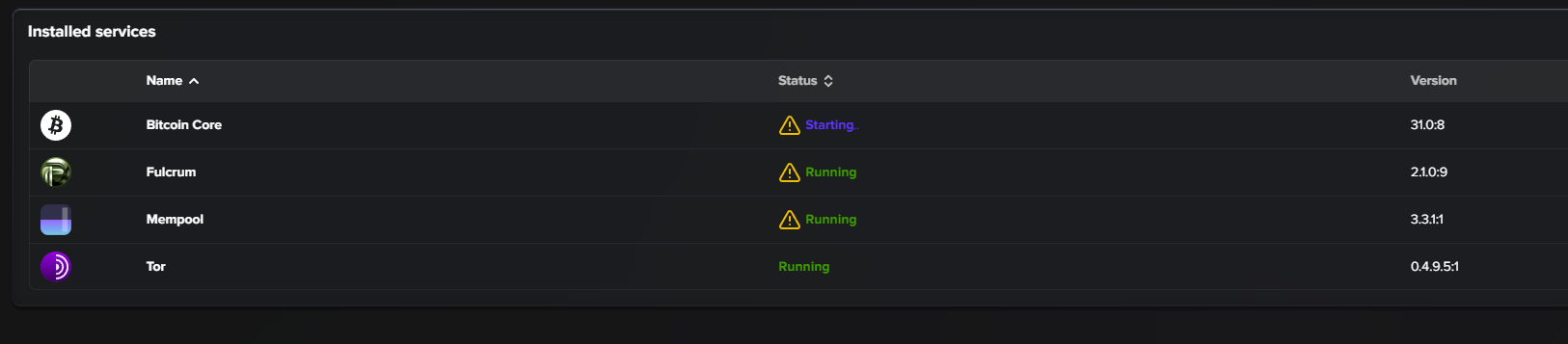

My server is running 0.4.0-beta.7 with:
Bitcoin Core 31.0:8
Fulcrum 2.1.0:9
Mempool 3.3.1:1
Tor 0.4.9.5:1

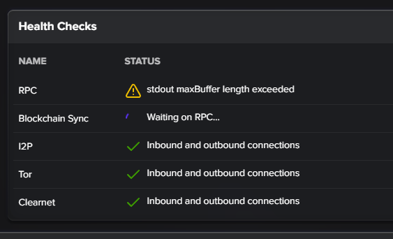

Bitcoin Core is fully synched and starts just fine. I can start Fulcrum, seems to be ok. But as soon as I start Mempool too, Bitcoin Core starts complaining about “stdout maxBuffer length exceeded”.
So everything keeps working as long as I don’t start Mempool.

I am on the latest version of StartOS and also the services, I checked and double checked, but it still happens.
This screenshot was made just a couple of seconds ago.
This happens a few seconds after starting the Mempool service
