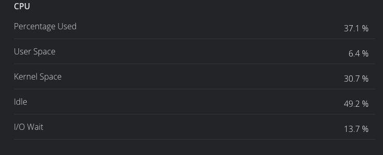

This suspicion is also backed up by the fact that the dashboard monitor shows more than 30% utlization (out of 37% total) comes from kernel space. This is very odd as Bitcoin runs in userspace - another pointer that it is the container/overlay abstraction in kernel-space causing the issue (not just bitcoin block validation being slow, which would happen in user space). The screenshot:

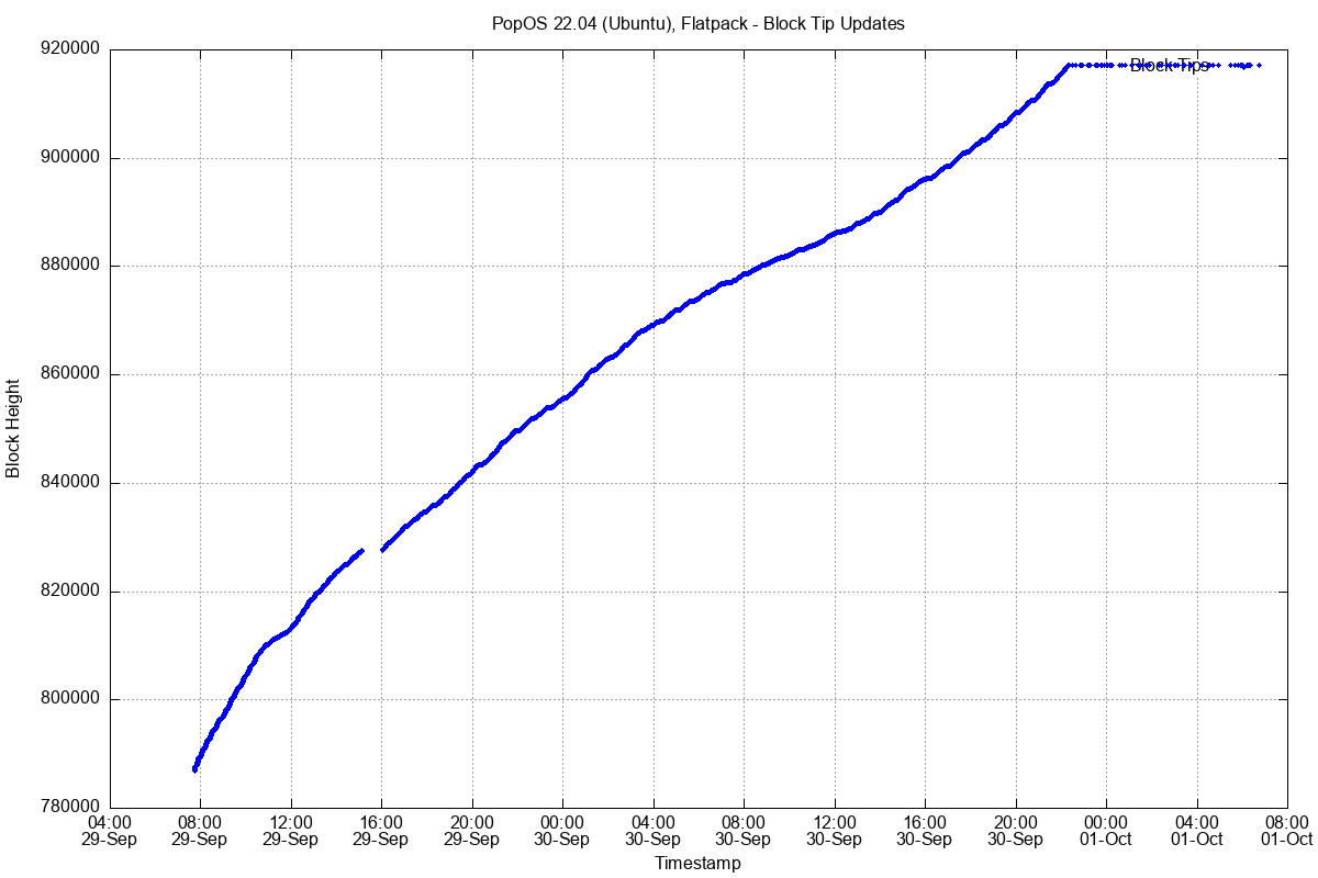

Update: Syncing on the Pop!_OS installation from 0 to 100% took 55h and was successful.
On the Pop!_OS installation (same machine, HP Elitedesk G2 800 with 8GB Mem and 2TB SSD) the syncing is faster and more consistent. There is a slowdown around blocks 750000 and following, so that area is the most interesting.

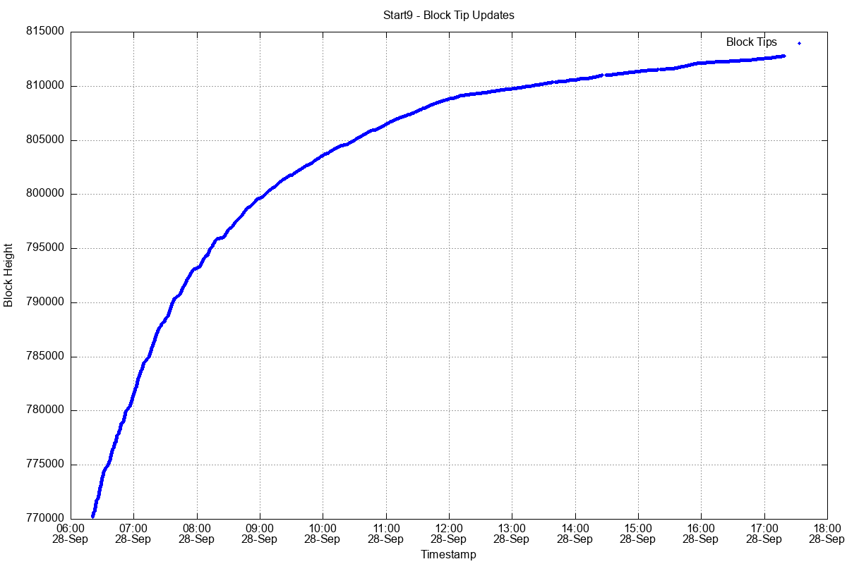

I created a script and gnuplot file that parse a debug.log file and plot the timestamp of the block validation (Update Tip message in debug.log) and the blockheight of the Tip into a plot.
These are the results:
Note that the debug.log files start and end of Update Tip messages are different, but the overall trend is obvious: The Start9 scatterplot shows that with increased block height, block validation gets slower and slower. The curve resembles a logarithmic curve, so there is an exponential growth of the slowdown.
The Pop!_OS plot (again, we talk the same machine!) is much more linear. there is a gap for about an hour between 15:00 and 16:00 during which I had to powerdown and relocate the machine for unrelated reasons. After restart I continued where it left off. The linear trend is obvious, much more what is expected.
