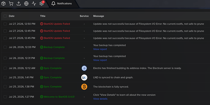

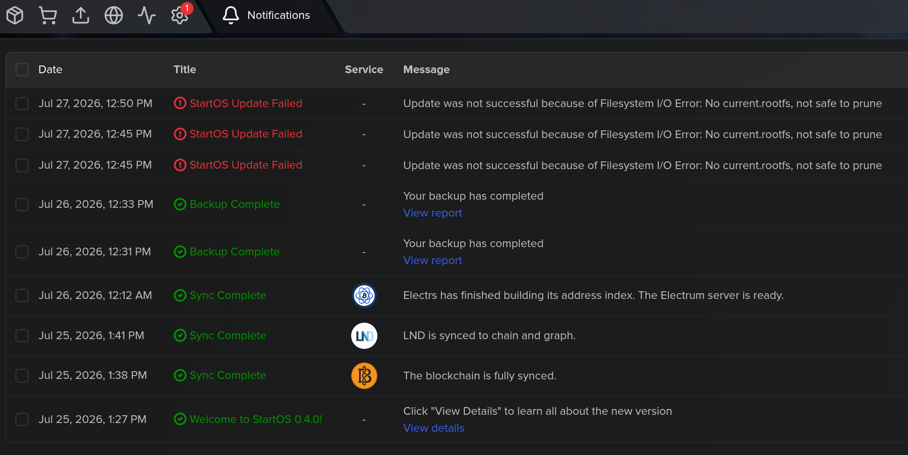

Cant update to StartOS 0.4.0.1
Looks like this minor version update recently dropped an hour ago from the time i’m currently writing this post, cant update to it however. Keep getting this error: Update was not successful because of Filesystem I/O Error: No current.rootfs, not safe to prune
Anybody else seeing the same thing, or just me?
This is an attempted upgrade from 0.4.0 to 0.4.0.1

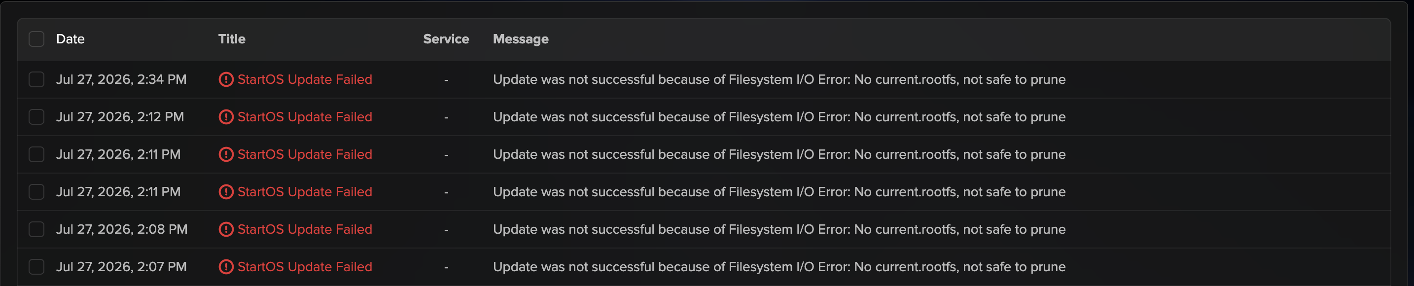

me too, same error, updating from 0.4.0
Hm, well the update just dropped an hour ago, still pretty fresh so maybe its a larger bug that needs ironing out, glad to hear i’m not the only one though! Hoping more people comment if they also experience the same thing
I have another start9 server, this 2nd one seems to be downloading the update ok…,. will see what happens
UPDATE: the 2nd server updated to 0.4.0.1 just fine. Rebooted and retried update on 1st server, failed again, same error
