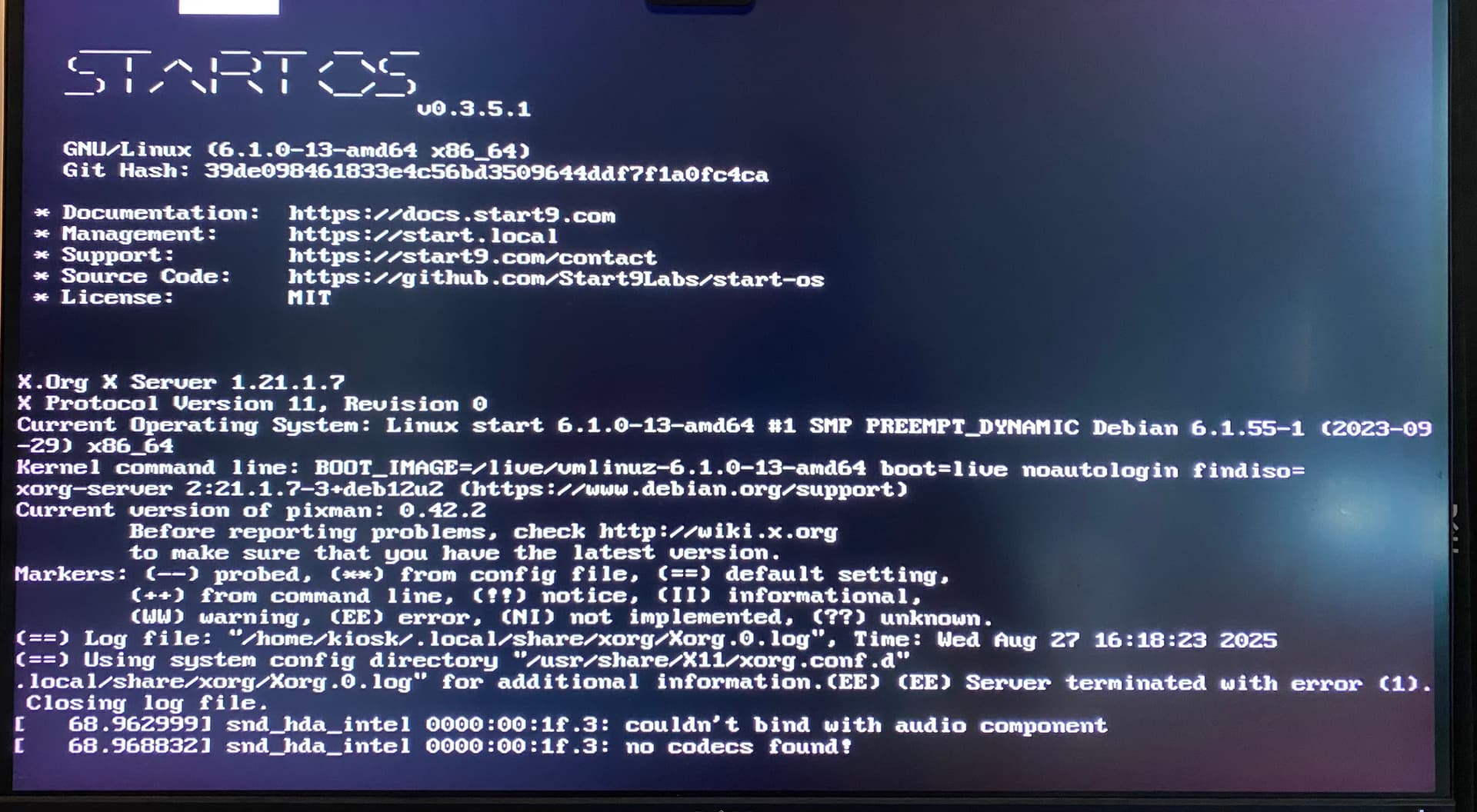

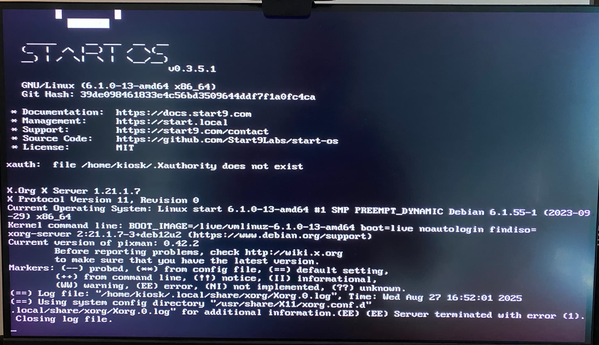

Actually, problem might be happening sooner in the process.
I realized that when booting the Mini pc with the USB-stick with non-free StartOS iso on it (also Secure boot disabled in BIOS), i’m stuck at this error page that keeps refreshing every 5-10 seconds. The 2nd image is another error page that appears only once about audio codecs missing, but then i comes back to the 1st image on repeat. I tried booting with no monitor/HDMI attached and going to start.local, still get the same error.
I have a Dreamquest minipc, Intel N150, 16GB DDR4, 1TB M.2 SSD
Any idea? Thanks!
Is it possible the problem comes from the fact that I’m flashing from a 128Gb usb stick? I read that flashing with stick over 32Gb can sometimes cause problems. I just ordered a 16Gb one, should arrive in 2 days, will keep you posted.

Inability to see the gui of the installer after booting the USB means either your monitor or graphics card in the pc is not supported even by the closed-source drivers included in the non-free ISO from the debian non-free repos. I’d try another monitor – but no matter, you should still be able to reach http://start.local via the network and see the same page that would be displayed on the monitor, and proceed from there, unless the PC’s network drivers are also not available.
