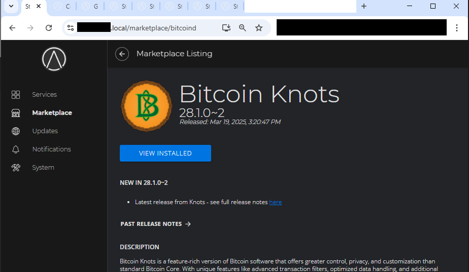

I’m trying to follow this guide, but there’s no “Reinstall” button for Knots. Am I doing something wrong? How can I make the switch?
I’m running StartOS version 0.3.5~1, which it says is the latest. I’ve tried System / Power / System Rebuild, and Restarting, but there’s still no Reinstall button (for any of the installed services - including Knots and Core).
Answering my own question:
Apparently the Reinstall button was missing because the latest available version of Knots is the same version# as Core that I was running. To work around the issue, I first changed the installer to an older version of Knots (Community marketplace, Knots → Other Versions), then the Reinstall button appeared. I installed that, configured it, then was able to update to the latest Knots.
This is not the case.
Reinstall appears when you click Manage 5 times. The only way it wouldn’t appear would be if your Bitcoin Core was out of date. If that was the case, yes, you’d need to update Core first to see the Reinstall button, or, as you did, choose an older version of Knots that matches the old version of Core.
Anyone who is running the latest Core will be able to follow the guide, anyone with an outdated Core can update first OR “reinstall” the same version of Knots.
It does now. It didn’t before, and I was running the latest Core available from the Start9 Registry (28.1.0~2). :person_shrugging:
