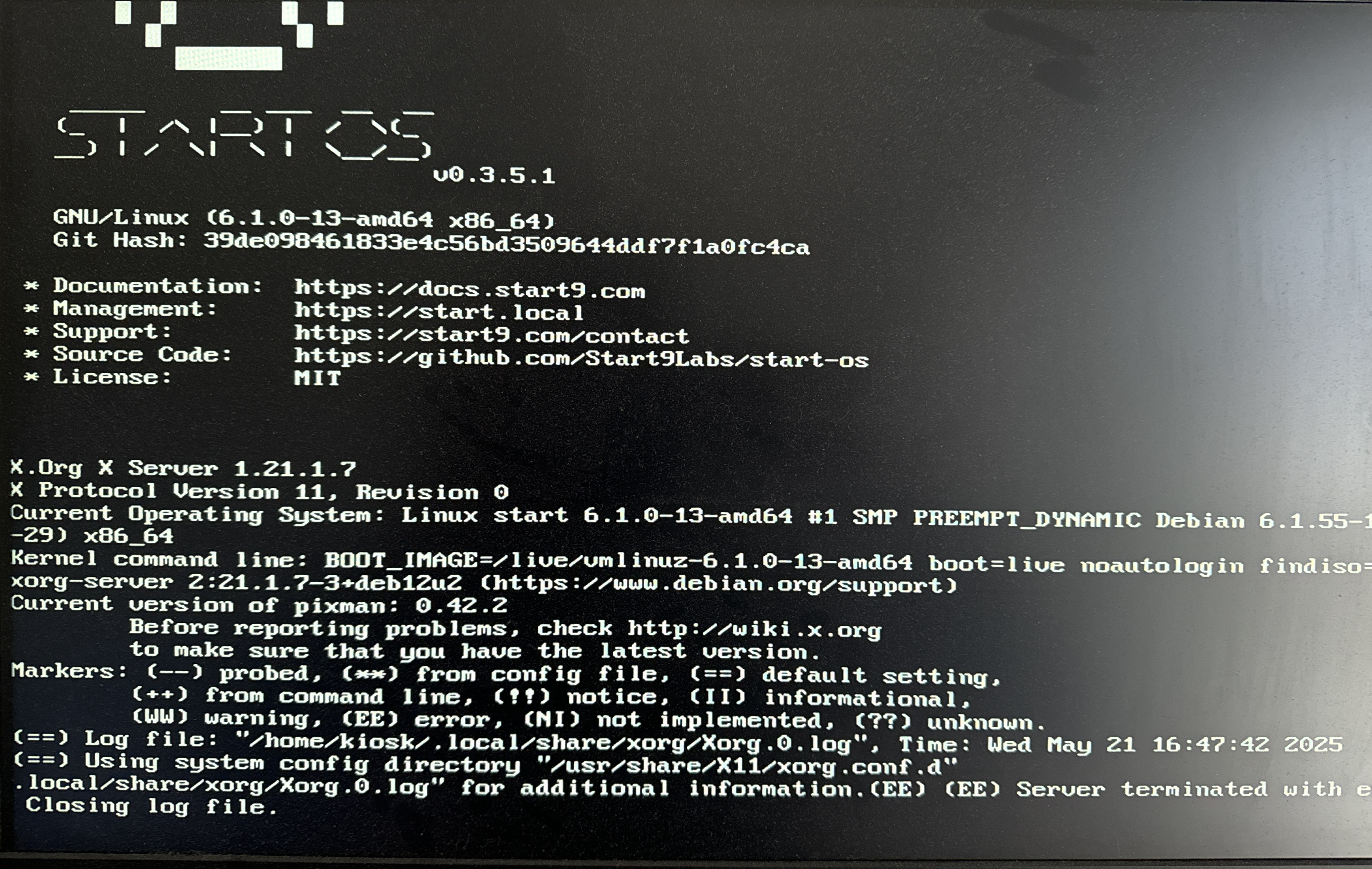

I’m trying to install startOS on my mini PC that I purchased recently. I was successful in flashing the non-free.iso file into a USB, but when I boot my PC using the USB, I get the error as seen in the screenshot (Server terminated with error (1) Closing log file).
Could anyone help me with understanding what could be happening here? I’m a beginner in this process, so any help is appreciated!
Here are my specs, in case it helps:
Looks like it doesn’t like either the graphics card or the monitor.
You’ll have to go headless, as per the guides. You should be able to access the device if booted up without peripherals from another machine at http://start.local to set it up.
