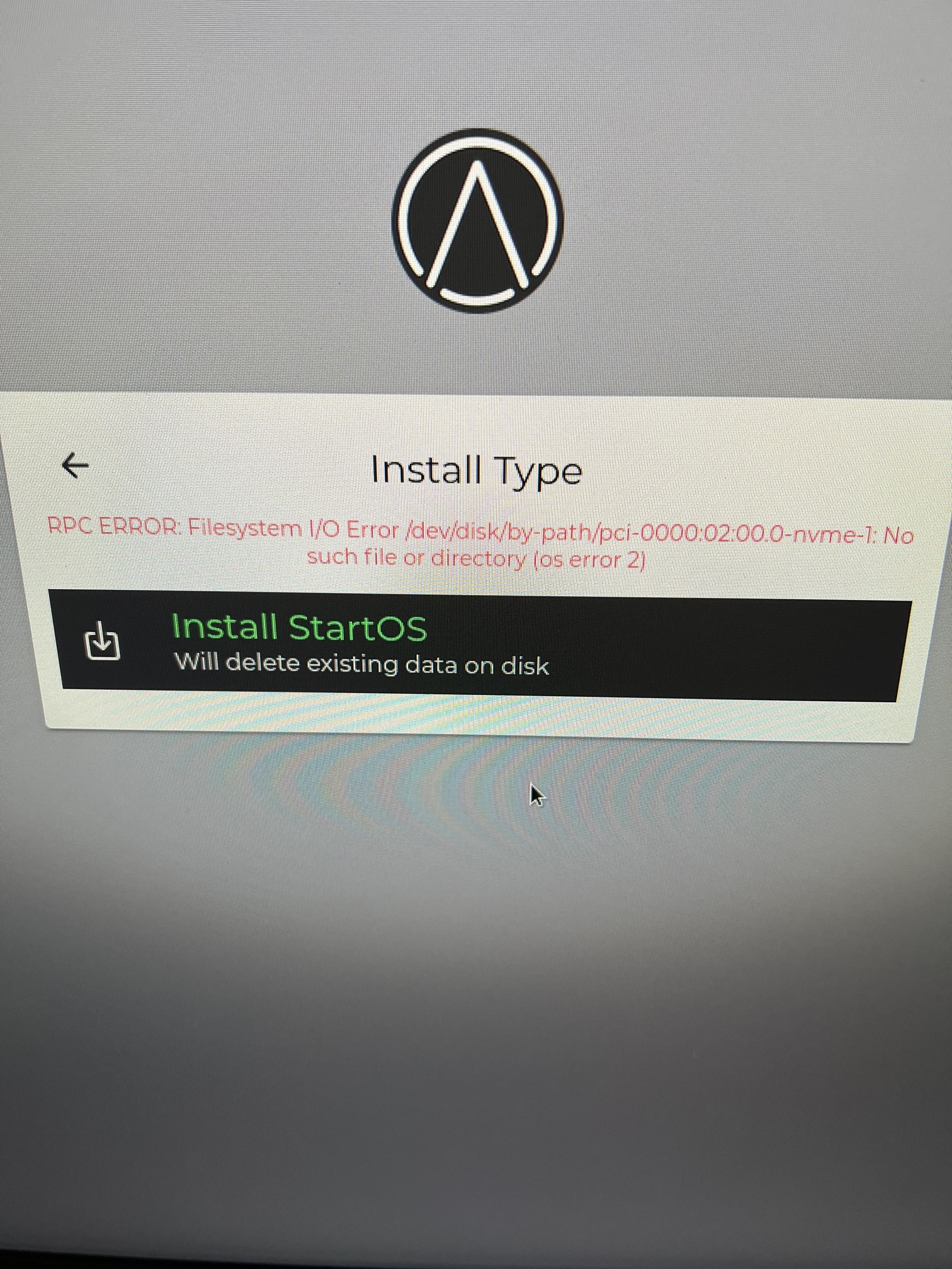

There was an additional error when after the initial one as well. I haven’t had a chance to look into this one but maybe you can look and shed some light by chance.
Photo: Second Error after I hit the Install StartOS button from the first error.
It might be the same thing, this error is more specific about it though. I think it’s trying to write, in this case symbolic links, to those partitions that aren’t formatted. If formatting it doesn’t fix your issue, we’ll see what more we can look into.
