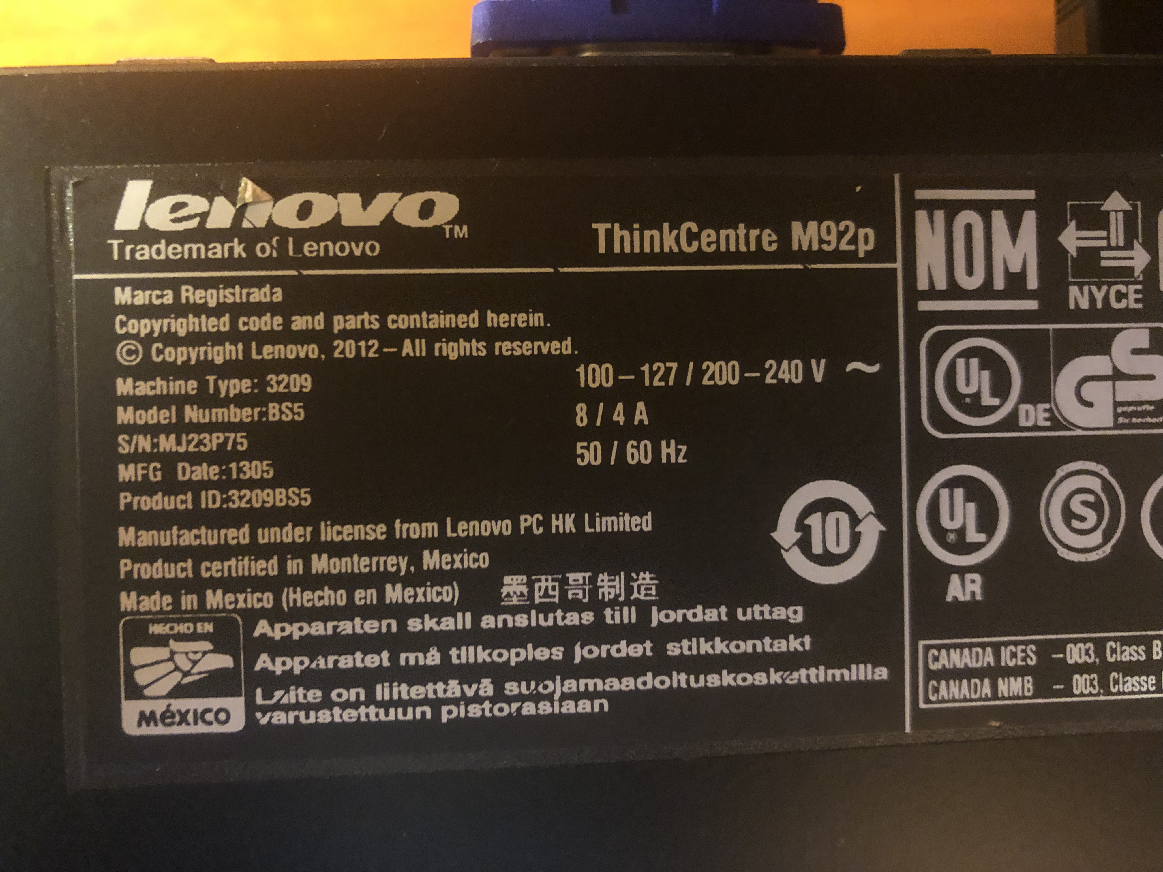

I’ve run StartOS to on a couple of Lenovo ThinkCentre variants (M93p and M710Q), and I frequently direct folks who are on a tight budget to this family of refurbished systems. I would really like to re-create and hopefully resolve the problem that you are experiencing with the ThinkCentre M92P. It seems that Lenovo made a couple different varients called M92P, though, so to make sure I get the same one you have, do you happen to have a link to a photo or listing that is identical to the one you own?

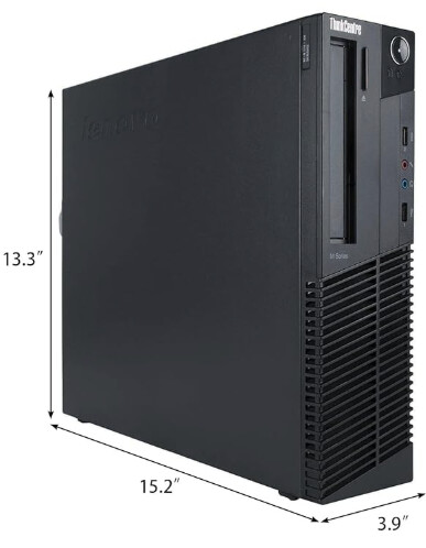

There are two variants of this model. There is the “small” form factor:

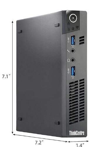

And the “tiny” form factor:
Sorry if this is obvious from one of the numbers in your photo there, but can you confirm which of these two you have? It probably doesn’t make a difference, but I want to be sure.
It’s definitely the small as it has the CD/DVD drive.
