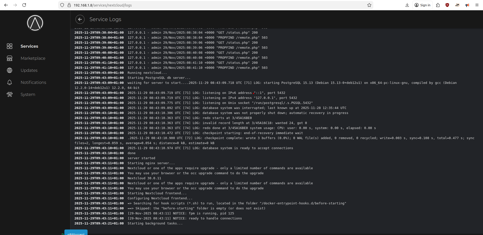

Looks like nextcloud has stopped indeed. Any idea how to get a solutions for this?
See attached log file as image
You can’t run the commands I asked you to run if you have Nextcloud stopped. You’d have to start it first.
