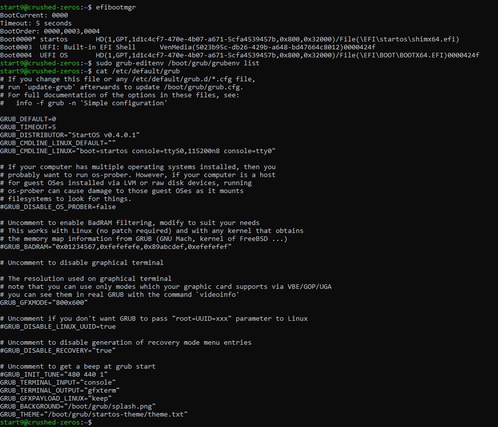

While StartOS worked well on an earlier similar Minisforum model (the UN1265), I discovered that the Minisforum UN1290 doesn’t go as expected. This model is running a newer/nicer BIOS (listed on the Main tab as “BIOS Version 1.06”, and in the footer as “Version 02.22.0058 Copyright American Megatrends International LLC”). The installation goes fine, but upon reboot, the miniPC behaves as if there is no bootable device.
After some tinkering, I’ve gotten it to work with a minor hack, so thought I would share here for anyone facing the same issue. The basic idea here is to place the bootloader at /EFI/BOOT/BOOTX64.EFI – this path is hard‑coded in the UEFI spec as the “removable‑media fallback,” so virtually every firmware will look there automatically when no explicit boot entry is found.

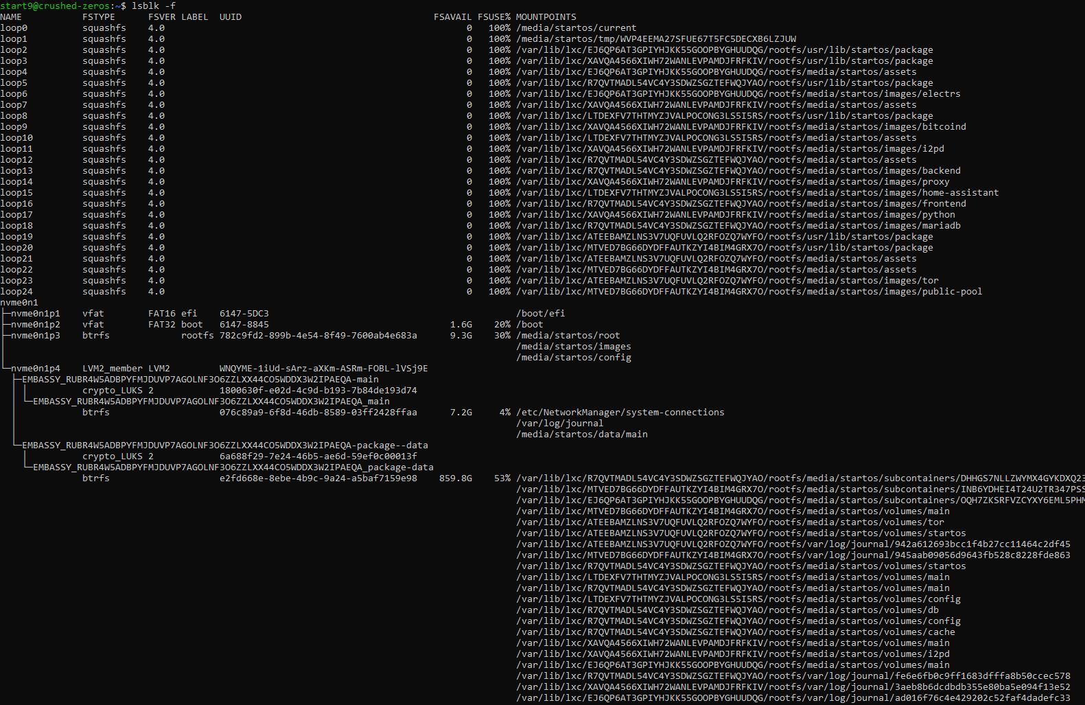

sudo mount /dev/nvme0n1p1 /mnt

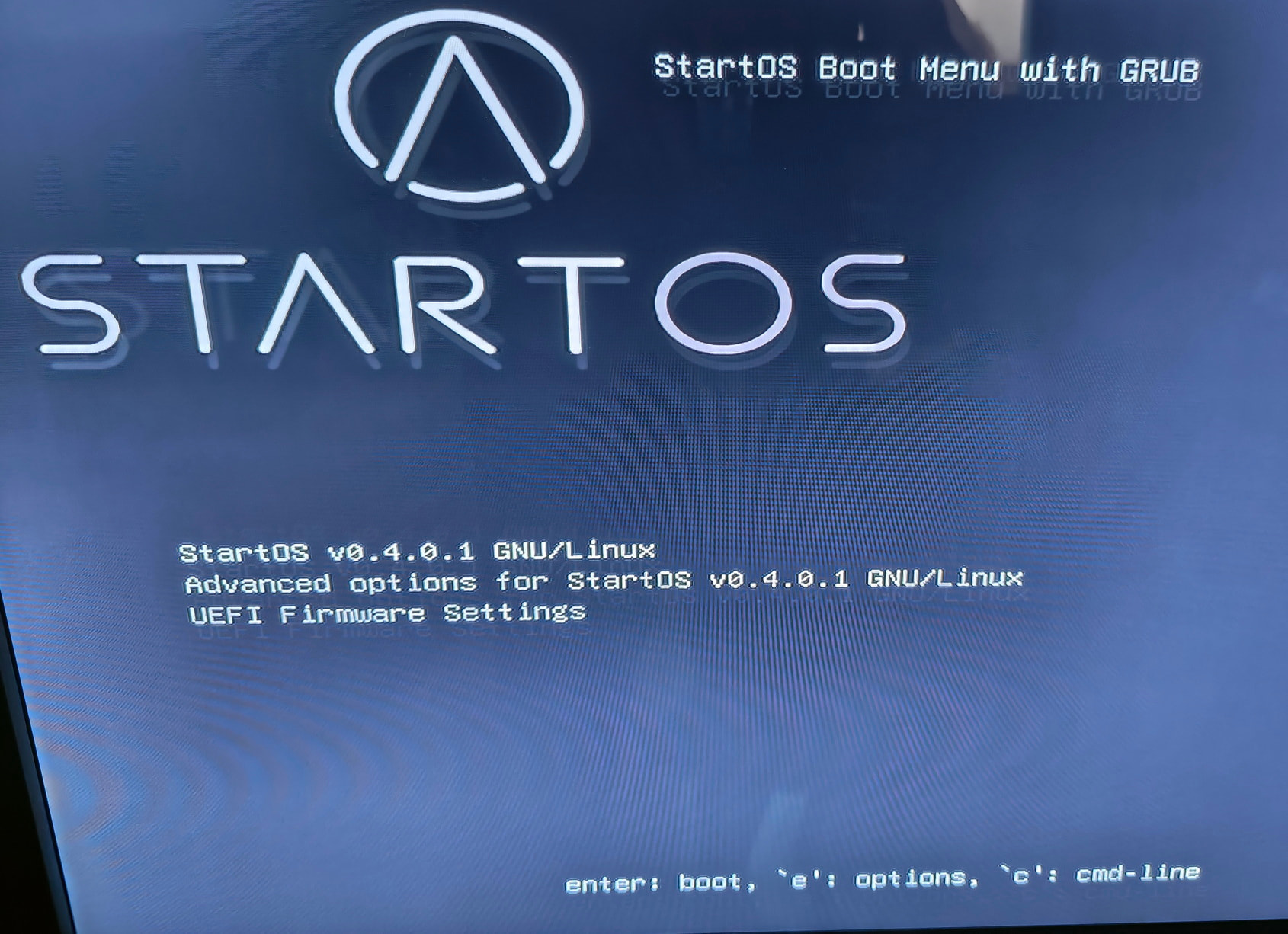

Reboot. StartOS should now launch.
